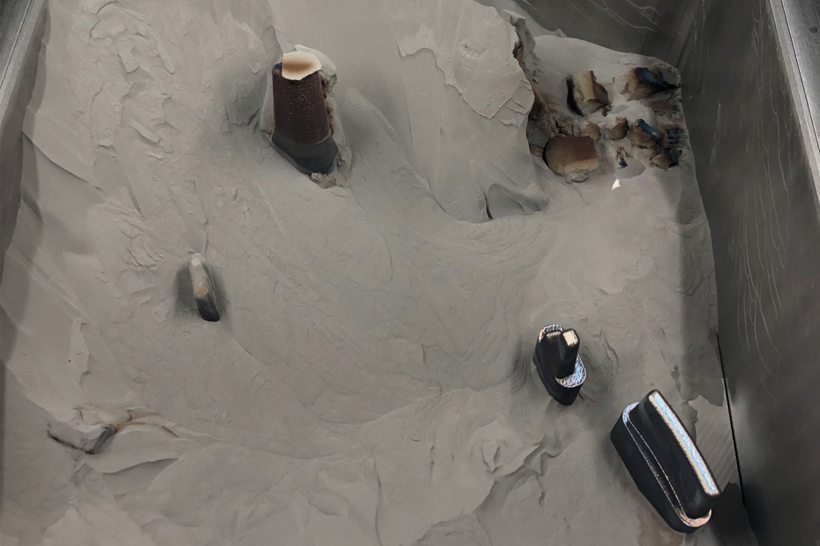

Figure 1: Significant overheating of the MS1 material. Photo provided by Exco Engineering, an Additive Works partner working with simulation to predict and avoid massive overheating.

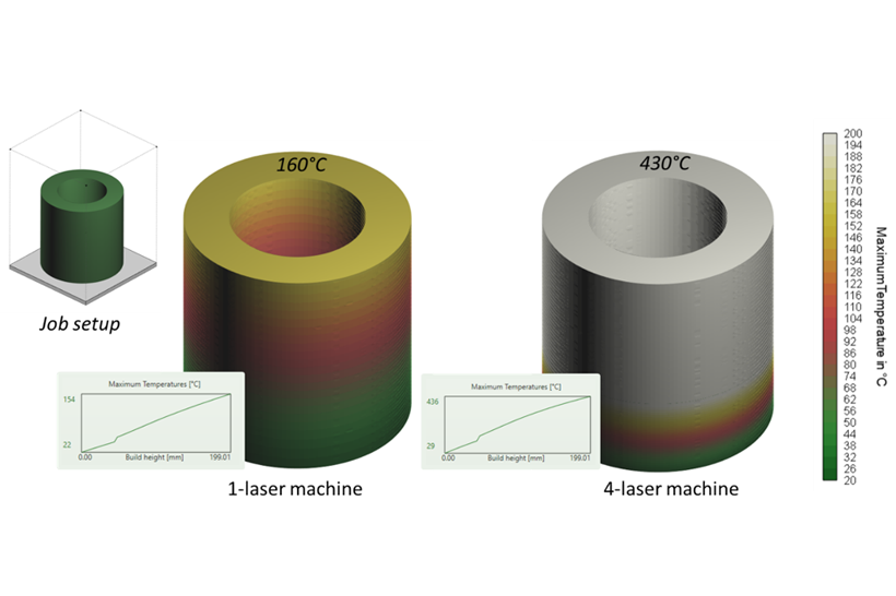

1. One vs. four laser machines
The first setup is a large tube that’s closed at the bottom side attached to the base plate and manufactured from MS1. A single-laser and a 4-laser machine are assumed to produce the part (20cm x 20cm):
Figure 2: Example simulations for a big massive part geometry comparing the maximum temperature reached in a 1-laser and in a 4-laser machine. The maximum temperature rapidly increases for the 4-laser process.
Assuming that the material usually becomes martensite if it cools down to room temperature, the result shows impressively that increasing productivity by using systems with more lasers may lead to changes in phase distribution. Basically, the entire upper part is of another material, behaving different in post-processes final as well as in the final application.

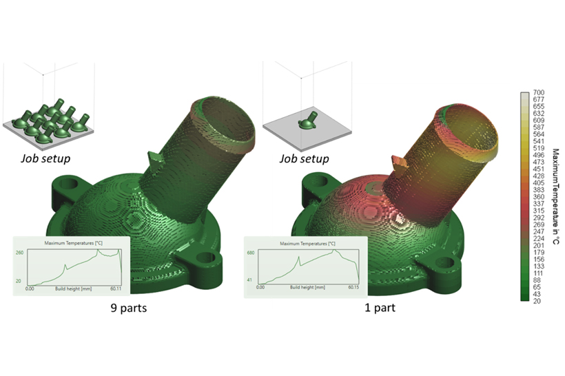

2. Nested build job vs. single part
Another effect you can analyze by using this kind of simulation is related to the number of parts manufactured on one plate. Since part build rates highly depend on the cross-sections of layers, nested build jobs have lower temperatures than parts manufactured individually. If your production is on demand, you may get significant differences in the part quality, depending on the number and geometries of parts, that have been nested on the build plate. To demonstrate this, we compared a plate with 9 parts to a plate with only one part, manufactured on the same machine from stainless steel 316L with equal settings:
Figure 3: Example simulations of a nested build job and a single part. Differences in maximum temperature are remarkable.
This result demonstrates the high impact of the number of parts per build. Thus, a single part benchmark experiment is not representing the situation for a production environment. Resulting part quality cannot be transferred to other parts if they have not been manufactured with the same base plate setup. One consequence is that if you build different parts and setups each time, you can’t expect reproducibility. Since the temperature increase has significant influence on the process mechanics, welding distortion and shrinkage can also highly differ.

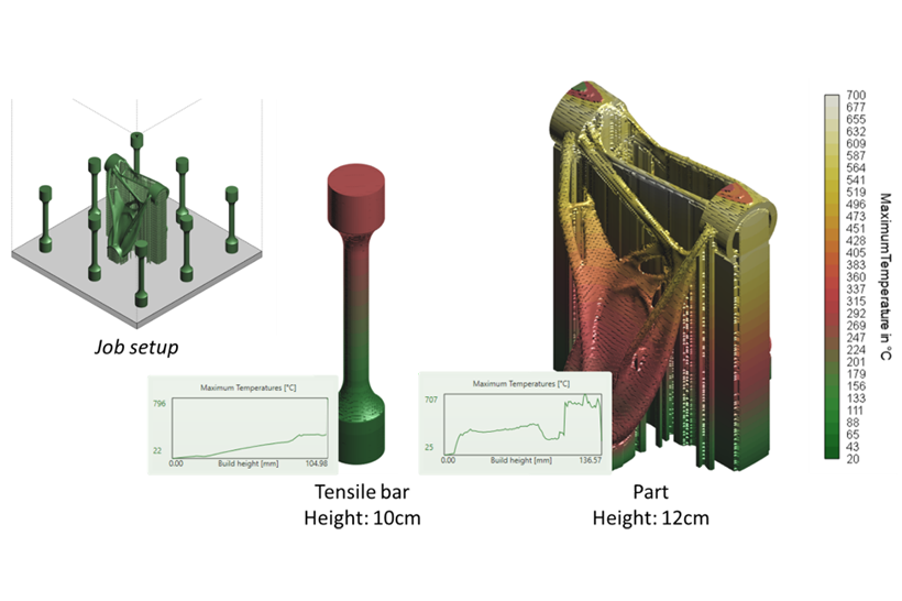

3. Different parts (with different height)
Experienced users know about this and other issues and manufacture tensile bars together with the part to ensure part quality by doing tensile testing of the built bars. Since tensile bars usually have a fixed length but the height of the part itself is normally not the same you run into another thermal situation for higher parts once all bars were finished. By investigating simulation results you can clearly see differences in maximum temperature, mainly induced by the much higher build rate of the upper region of the part. An example simulation with 8 tensile bars around one part has been conducted for the Ti64 material.
Figure 4: Example simulations of a part together with tensile bars for material characterization. While the tensile bar does never exceed temperatures of 300°C, the actual part is overheated to 600-700°C in the upper region.
Since the material properties result from the process itself and vary with the thermal situation, it’s obvious that the part might have different material properties than the tensile bars. Thus, the material characterization of the tensile bars cannot be reliably assumed for the part itself, although they were built within the same process. This results in a situation where it’s hard to conduct a reliable experimental characterization of the as-build part quality.
