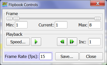

2 – Frame Rate Control
Use Frame Rate to speed up or slow down the playback of your movies. The Frame Rate can be set between 1 and 60 Frames per Second (fps), is embedded in the saved MP4 and you can change the Frame Rate and save the movie again without having to regenerate the movie.
Have a look at this movie to see the difference between 15 and 30 fps.

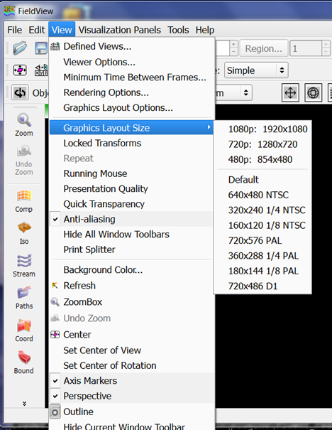

3 – HD Graphics Layout Sizes
Select standard HD layouts including 1080p, 720p and 480p to get the size, aspect ratio, quality and file size you need.
Note that the Frame Rate video was saved at 720p. When you view it on YouTube, you can adjust the settings to view the movie at up to 720p resolution.
