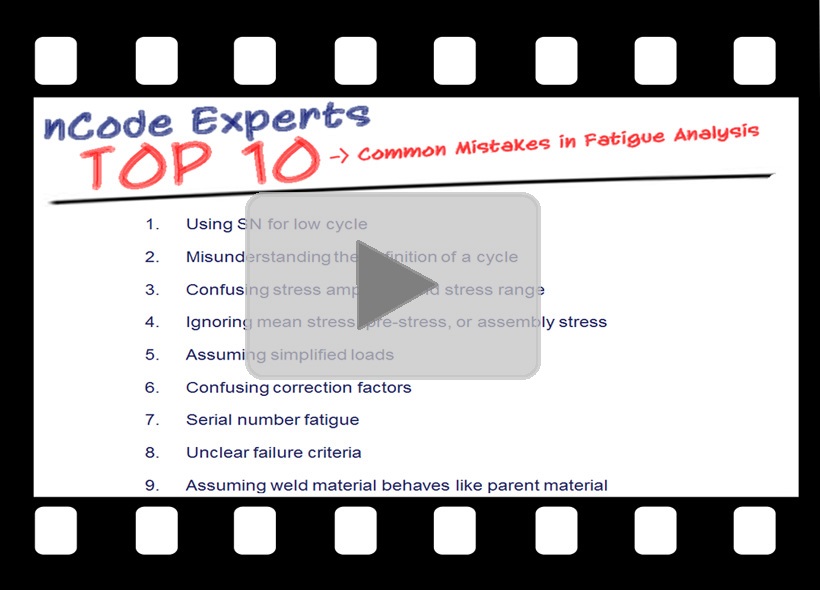

The answer is this: we need to focus on making the most of fatigue analysis by eliminating common mistakes. A common mistake is highlighted by the often-asked question: “Should I use the stress-life (SN) or strain-life (EN) method for my part?” These two methods are commonly confused. They seem so similar! After all, aren’t stresses and strains pretty much the same thing – a structural response?
Dig around and you’ll find that the difference boils down to high-cycle and low-cycle fatigue. The stress-life method doesn’t apply to low-cycle fatigue – a regime that we often design in due to cost and weight challenges. The decision regarding which fatigue method to use is important!
Watch this 30-minute video in which we’ll steer you clear of common mistakes in fatigue analysis - and discuss best practices.
