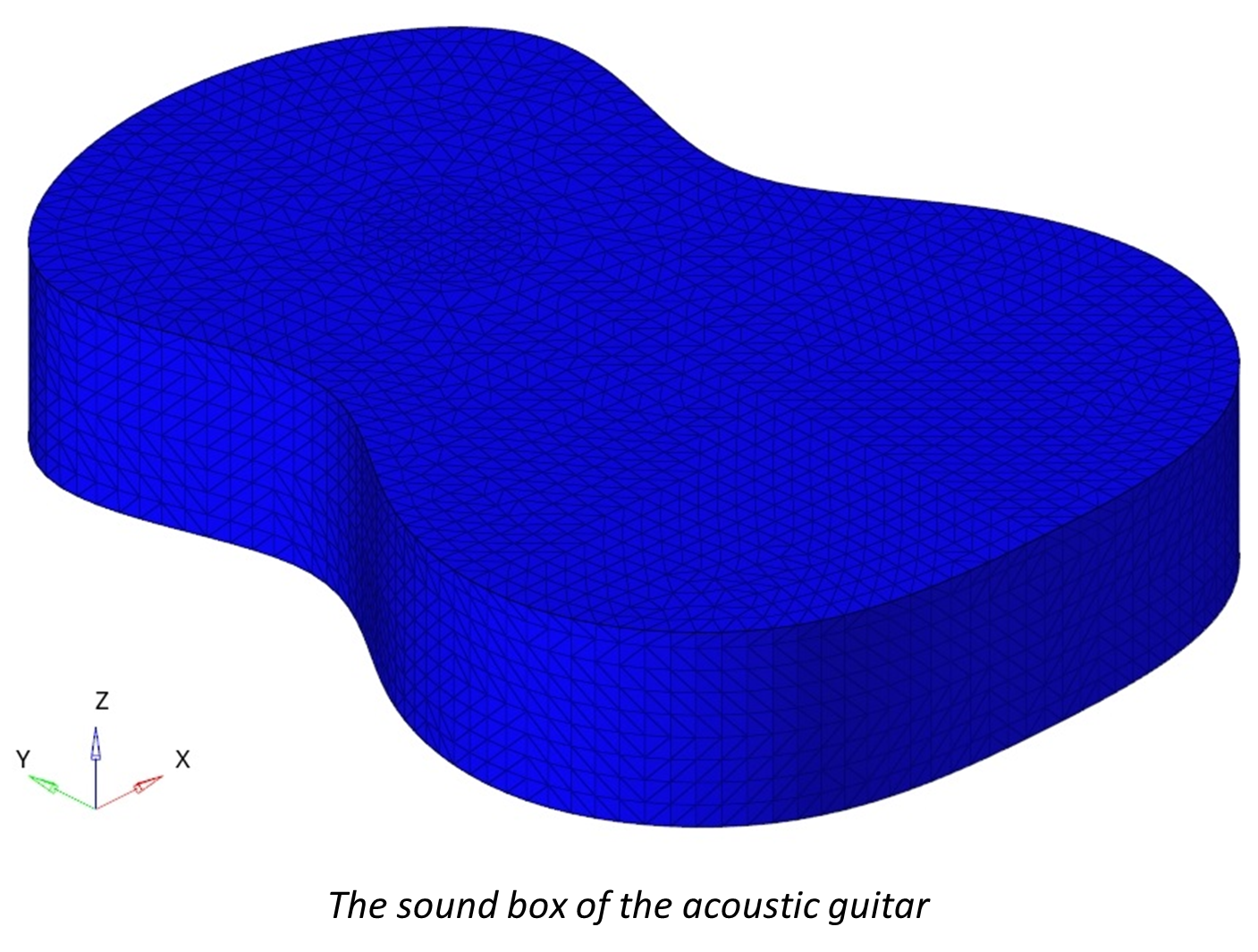

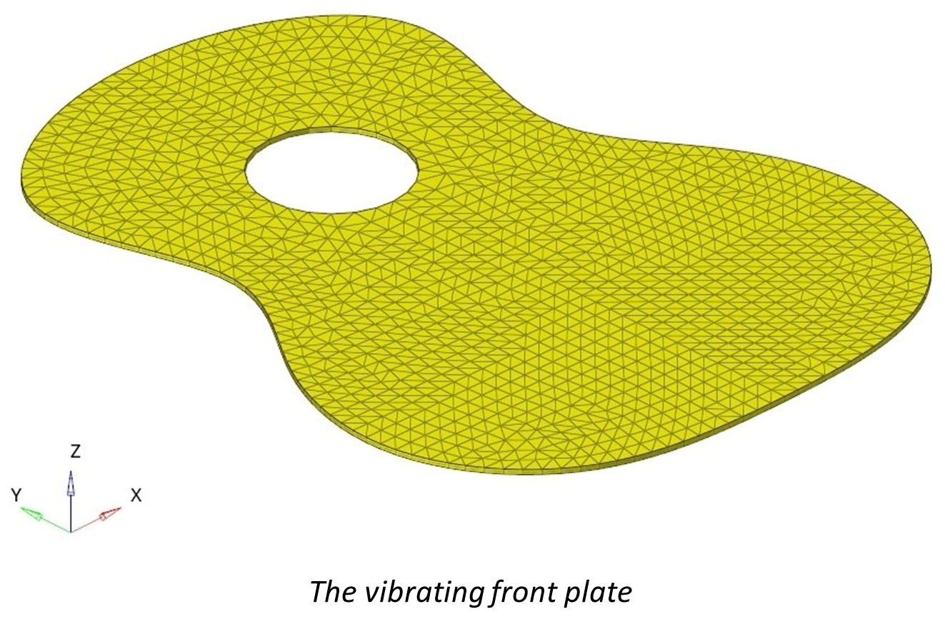

First, we created a model of an acoustic guitar along with a vibrating front plate, simplified as a structural model of the solid elements.
The sound box of the acoustic guitar
The vibrating front plate

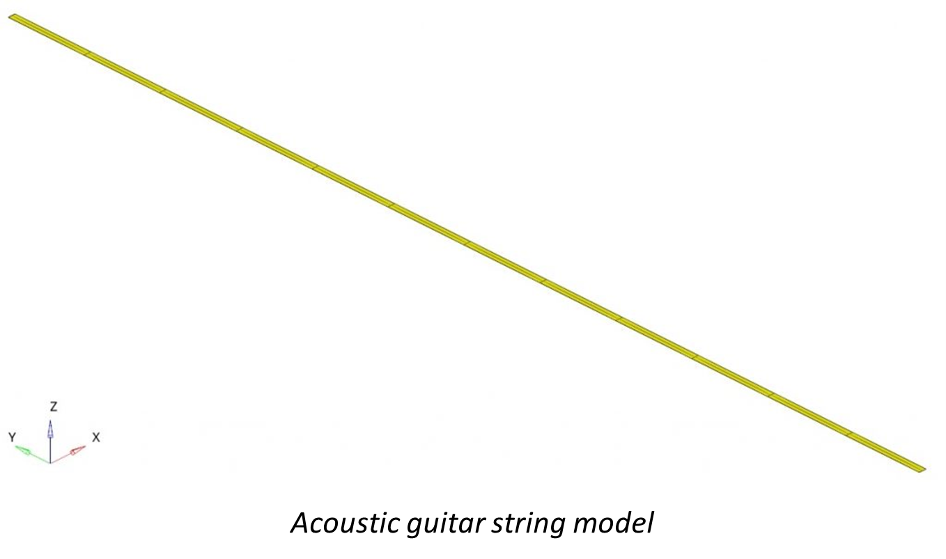

Next, we created a model of a guitar string as a structural model of the shell elements and placed it where you’d find the strings of the guitar.
Acoustic guitar string model

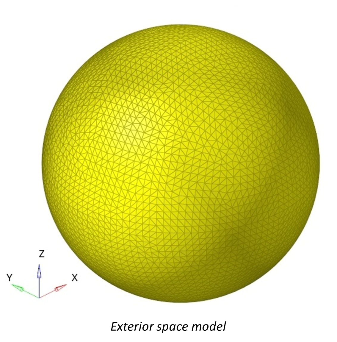

In the external space, we created a spherical acoustic model with a radius of one meter around the guitar model with solid elements. We set an acoustic infinite boundary element on the surface with an evaluation point (to represent a microphone) placed two meters in the vertical direction from the center of the sound hole.
Exterior space model

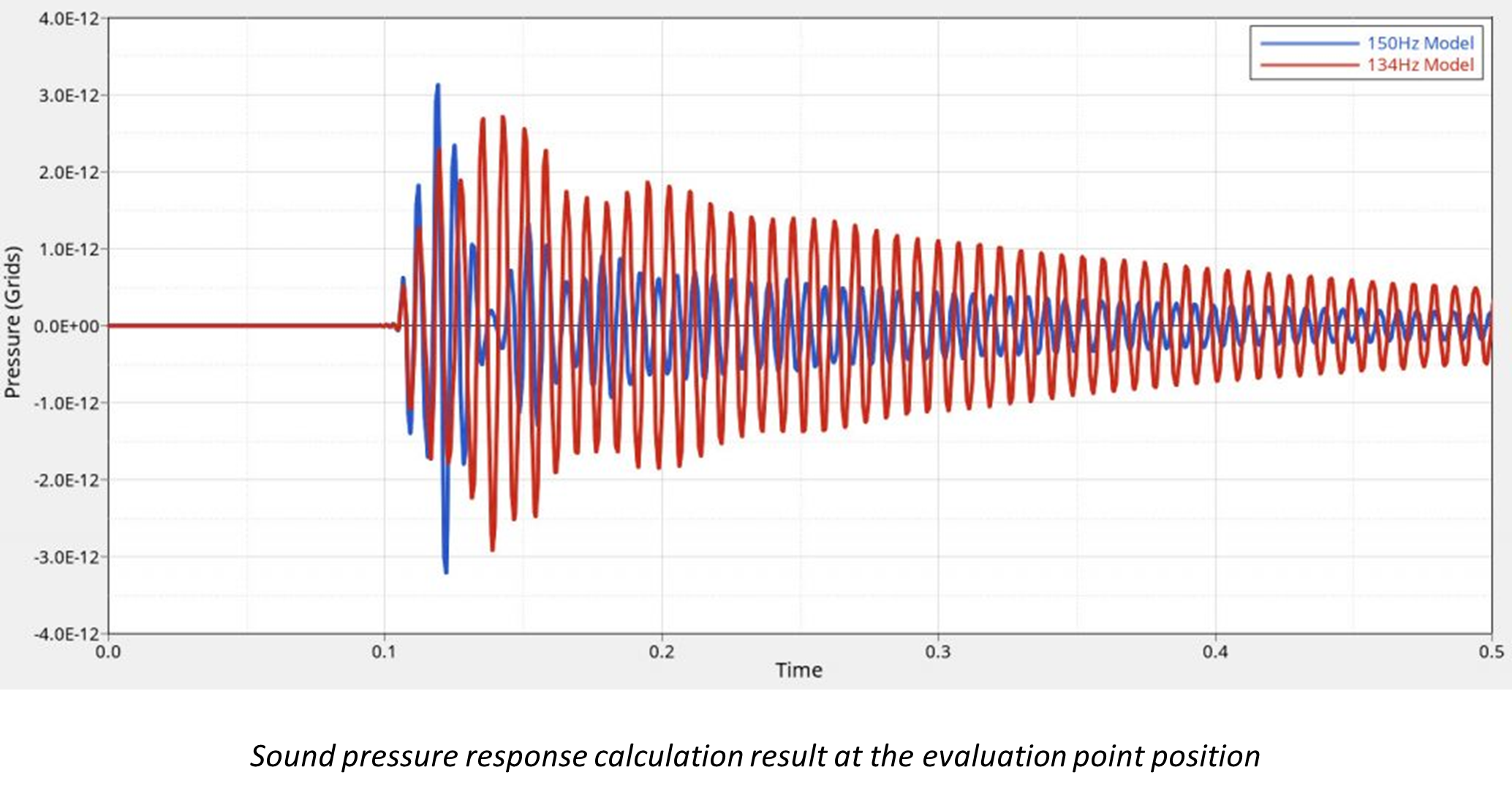

In this state, we performed a transient response acoustic analysis using OptiStruct. Under the same conditions, the strings used for this test were set to 134Hz, about one note lower. We then compared the results of both tests by performing calculations with a model where the physical properties were adjusted so they don’t resonate.
Sound pressure response calculation at the evaluation point position
As you can see in the waveform above, when the natural frequency of the string is 150Hz, the sound pressure rises and decays quicker than a frequency of 134Hz. When the instrument’s frequency matches the frequency generated by the string, the resulting wolf tone takes over, becoming louder than the sound of the string vibration itself. It’s thought that wolf tones and those of string vibration cancel each other out, leading to a fast decay.

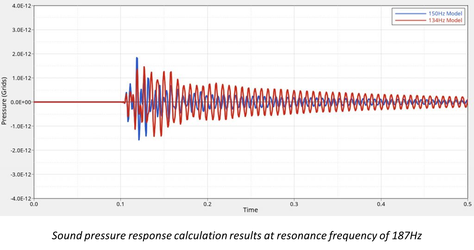

To expand on this further, we performed the same calculation for a model in which we changed the resonance frequency to 187Hz, representing a smaller, thinner instrument body. While the wolf tone still occurred, it was less pronounced.
Sound pressure response calculation results at resonance frequency of 187 Hz
