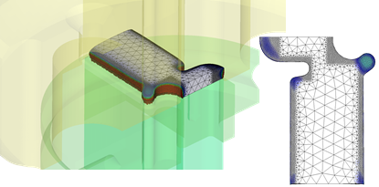

Fig. 2 shows a typical example of a 3D function. The characteristics of this process include force-imposing dies and tools, piercing process, and local mesh density control to get a better solution. In most cases of plate or sheet forging processes, load-applied region does not experience any plastic deformation during being plastically formed. For this region, a coarser finite-mesh system is recommended, as can be seen in Fig. 2. When a user selected the plate/sheet forging as their process type, then the program automatically supplies such near-optimal finite-element mesh system.
Fig. 2: 3D application of AFDEX 3D to plate forging

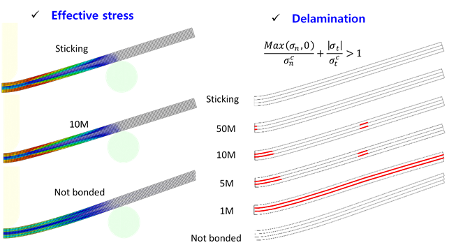

Fig. 3 compares predictions with experiments of an Al-Ti composite material sheet metal forming or plate forging process. Because of the importance of the thickness variation and delamination phenomena around the corners, plate forging simulation technique is useful for this case. Layered finite mesh system is shown in the figure. Finite-element analysis of delamination phenomena can be made. Fig. 4 shows the variation of delaminated region with bonding strength of interface.
Fig. 3: Al-Ti composite material sheet forging process
Fig. 4: Finite-element analysis of delamination phenomena
Piercing and trimming are also one of important topics that should be carefully treated in the simulation for being used in the consecutive process. In this simulation, some special functions for imposing very fine mesh system near the fracture region and for good surface quality enough to be employed as preform. An example is seen in Fig. 4 with emphasis on the mesh density for both computational efficiency and solution accuracy.
Fig. 5: Trimming process simulation using a special mesh density control function
